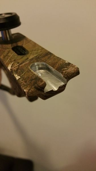

The milling of the ILF slot:

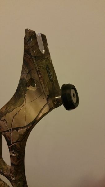

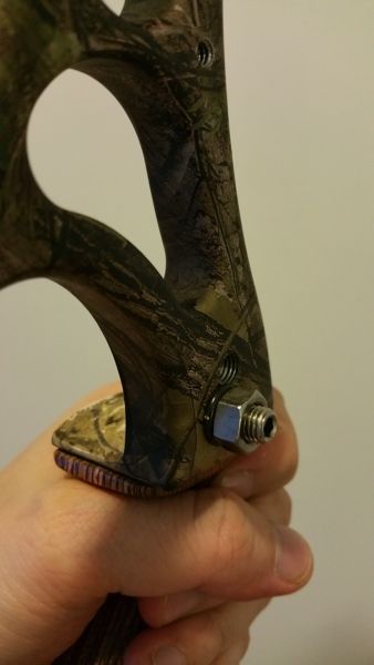

The replacement limb bolts and bezels. VERY nice. And it takes a 3/16" hex key... no more pesky 7/32 Hex key like the Hoyt original:

Close up of the adjustable centreshot screw:

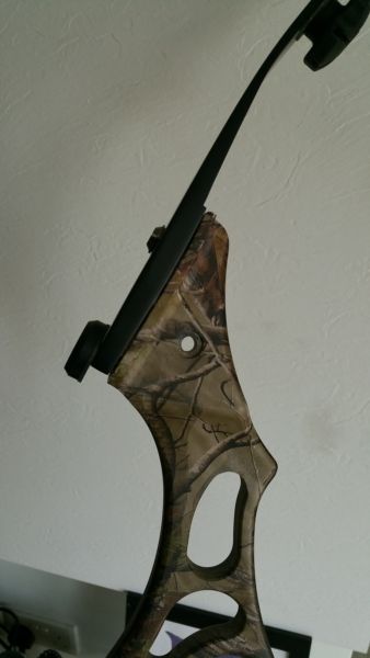

Kaya kStorms mounted - you can see the limb wedge is very flat, so I've got the bolts fully turned in (and slim strips of rubber on the riser under the limbs.)
Mounted - all is straight and true:

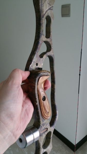

I couldn't agree more except mine would have referenced the Dorado riser. I've had just about all of them and preferred the Dorado riser to all I've tried--but it wasn't ILF. Jonhdo took care of that in impeccable fashion.
After all these years, I now have what I consider my perfect all around ILF riser.

The limb pocket

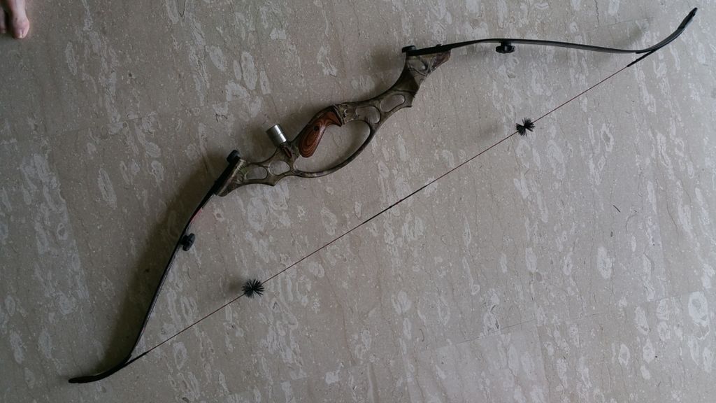

I still a regular bolt down GM2, and I put some thin adhesive backed rubber on the limb pads where the bolts contact. When tuned, it is very silent - though I also have cat whiskers, velcro on the string groove and yarn on the string.
On my ILF version, with TT BlackMac Wood/Glass limbs I'd say it's very close. The bolt down would be marginally quieter... but with my current ILF 35# set up on a 8" BH, it's practically the same nice thump.
So you're not losing anything going to ILF - the only thing to be fully aware of if that the limb pad angle is not as low as a typical ILF... so you lose performance (but gain smooth draw and the adjustability of ILF). Only kaya kStorm limbs that I tested, I lost almost 10fps just by changing risers.
