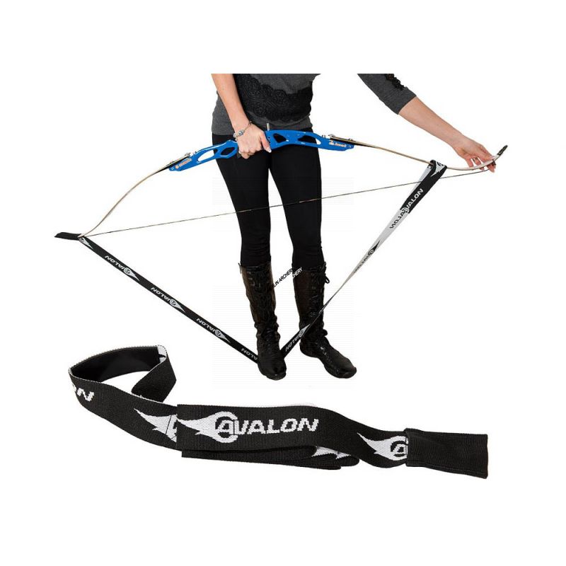

I use this with my N3's, all my limbs now. Bought it in France when my N3's burst a hole in the pocket of my Selway cord stringer. All the Oly guys were using them. Bulkier to pack, but never going back to a cord stringer if possible. Very stable.
I'm not familiar with any stringer that fits over those small tips on Uukha's and Nika's. I use the same style as remote. It's sold under a lot if different names. The strap doesn't seem to slip like the rubber block does--at times.
Walmart sells it under the name:
Tebru Recurve Bow Stringer
#5 ·
Agree Jim, the rubber block, even on the big wide blocks on the Saunders and Selway, can slip esp when wet. The simple strapping style ones are so very stable and naturally adapt to any limb and limb tip. Also feel safer relying on these strap types compared to paracord passing through / wearing away rubber, esp when stringing heavy bows.

The strap type of stringer posted by Remote works well with any recurve (haven’t tried with a longbow) and really excels when stringing super curve limbs like Borders. I'm also a fan of the Limbaver rubber block stringer which is good but doesn't work quite as well on the big hook limbs.
