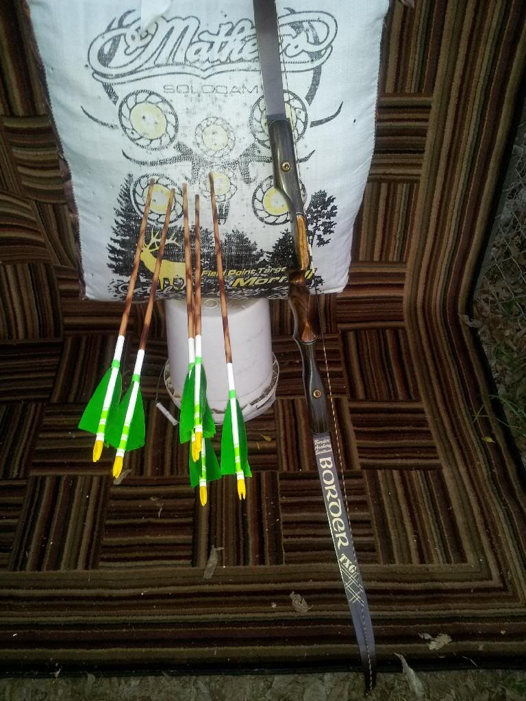

Graysquirrel sent me a dozen woodies I made it as hard as I could for him, I made an error typing my address. All turned out will. Thanks Graysquirrel.
I am going to shoot them off some hotter limbs but I wanted to see how they shot off my "Old Darling". This is my first group at 17 yards. Not so hot but I was finding my cant and working in my three under, middle finger anchor. Even so you can tell the arrows are a bit stiff. This is good since I am going to shoot them off a super curve limb.

I loosened the hex nut that lock the limb bolts down. Turned the limb bolts in I&1/2 turns. Ok got my cant, got my anchor locked in. I poured it on.

I think I'd be scared to stack them pretty sticks so close together rusty.....

I repeated the process. Screwed the limb bolts 2/3 turn out.
Hmmm I may shoot this tune awhile

To me, it seems wooden arrows react very predictably to draw weight tuning. Well this is especially in lighter weight spined arrows. You can dial them in. They react much more than carbon arrows do to draw weight tuning.

Yup, tuning the bow to the arrows is a superior attribute of ILF - you didn't have to settle for the first group!

BTW,Nice dialling it in,it shows what these set ups are capable of.
