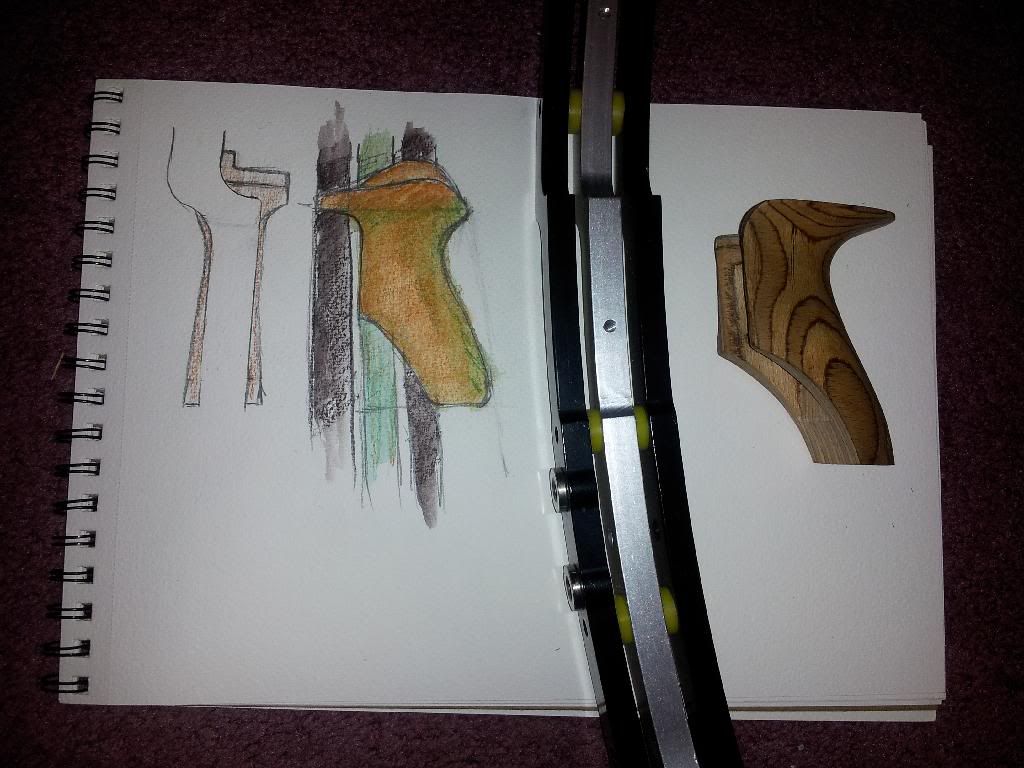

23" Revolution. The pivot point of the riser is over the grip off the belly of the riser. Using Rasyad's scheme itbwould be easy to make a grip to shoot off the shelf.

Hey Rusty,
Nice concept and great sketch. Let me know if you want any materials.
Rasyad

As a try and tape I flattened a side on a wooded Dowell. Tested the length till I could fit an upright arrow pass that would put my arrow down the line. Took, me about 30 minutes till I putting arrows on the spot.
Not sure where are how I am going with it but I is kinda nice. I stuck it on with industrial double side tape. Notbsure would last long

Rusty -
As big as the footprint of the top of the heel of the grip is, you could just shape a block of wood to match that footprint. Front edge of the block simply butts up to the back face of the riser. Put a 5/16" bolt with a leather/velcro tab face into the the plunger hole (grind the bolt head thinner if needed). Radius the top of your "shelf" block to line it up both vertically and fore and aft with the bolt face. Could then either epoxy the block to the top of the grip or DF tape it.
