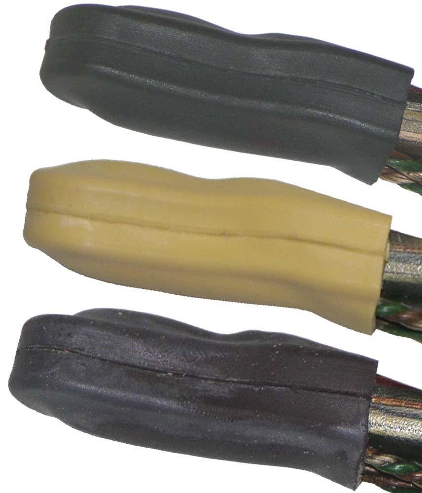

For that small tip you can get a baby nipple for bottles and cut a small section off and slide on or get a small piece of leather and make a sleeve and slide on with a hole for the string to slide thru. This is what we use to use back in the day before commercial ones we’re available like in 3 really vers catalog. One of my favorite methods was to get shrink tubing and cut a small section and heat it up over the tip
#17 ·
Cheers for that CD. I do have a pair of those and did give them a try. They were too long to get on, but cut in half they fit OK. I reckon at 25gn for each half they are a bit heavy, removing benefit of having a nice light tip in the first place, and being quite bulky will catch on sticks and leaf matter. Was worth a try though!
