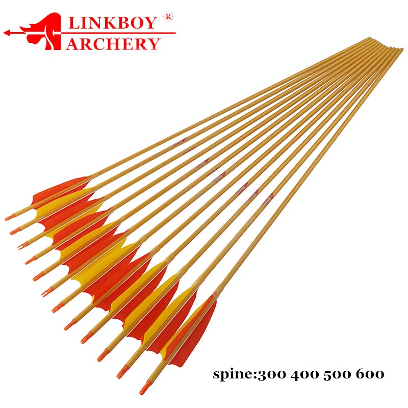

So looking at something like this, just because it's a tab I happen to have open right now, despite it being carbon and not my preferred aluminum..
If I went with 500 and 175 grain point @ 31" I'd get a total of 401.61 grains.
If I went with 600 and 125 grain point @ 31" I'd get a total of 319 grains.
That first suggestion would put me close to the minimum at least, the second one is 86 grains off, which seems much too light? Again I'm open to learning, this is all new to me, but did I do the math right there and you're just suggesting a very light arrow and ignoring the warrantied min GPP?

Never heard of those brand of arrows. The only ones that I can get under 8 grains per pound of finished arrow weight are expensive target arrows like victory vaps. Get easton or black eagle traditional carbons or easton gamegetter xx75. They will finish out between 9 and 11 grains per pound.
Spine tuning is more important than weight if you want accuracy.
