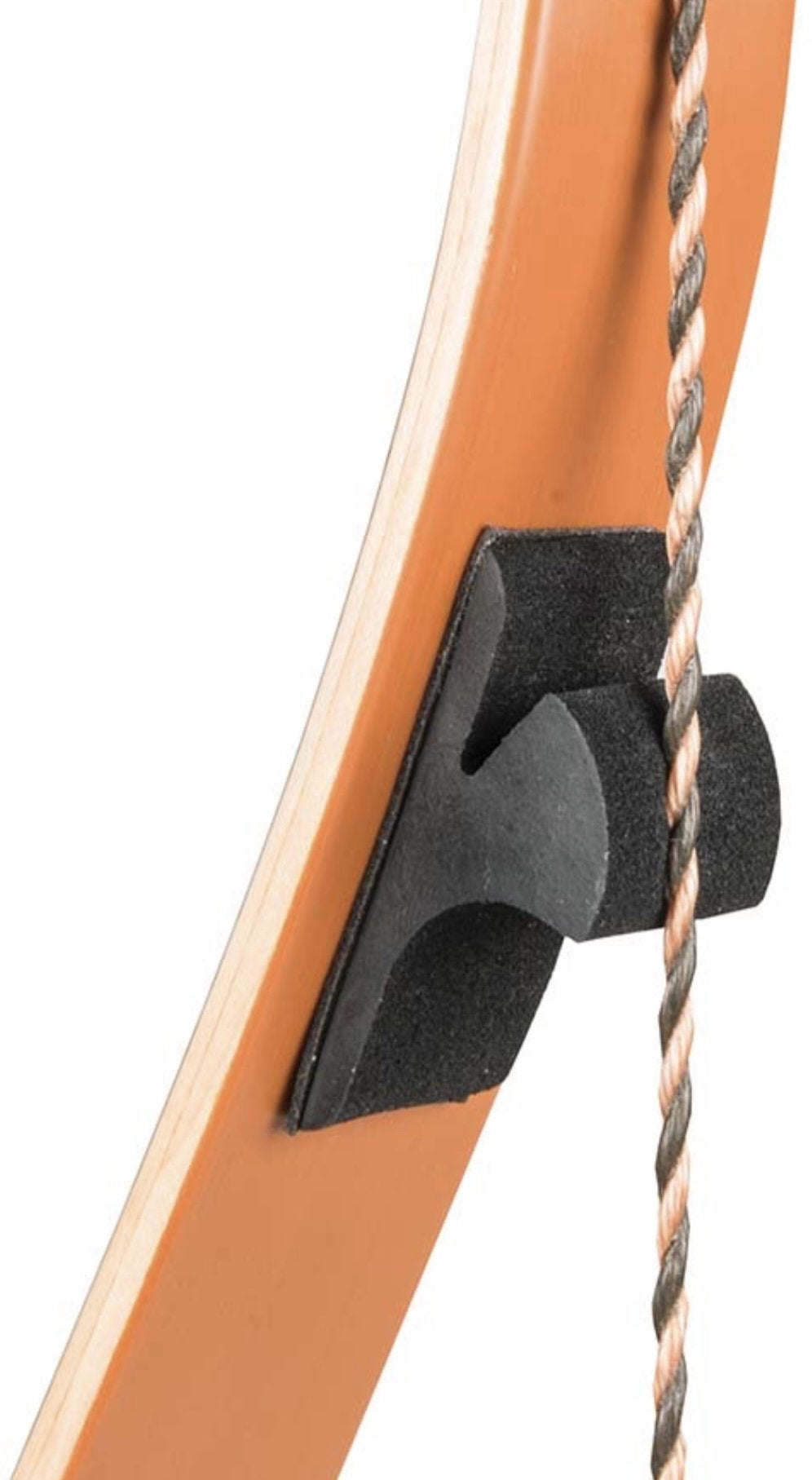

Have put Mole skin on the curves to help silence them. The late Sid Ball shared a good way to silence the string in the curves when the string hits brace after the shot.
A square of soft Velcro sticky back about an inch square placed were the string meets the curve in static position and allowing it to touch the string about 3/16's of an inch.
Contrary to what most think, the string only makes contact in this area dynamically when the string bottoms out after the shot. I've heard of people using brush busters at the same point to cushion the string along with other rubber like string cushioned like these.
