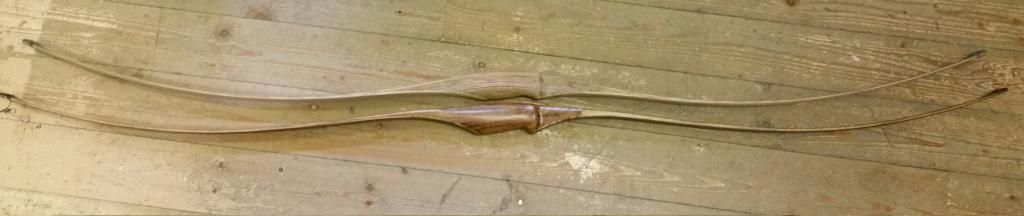

i will see if i can get some photos of two to compair back to back.

Anyhow, as promised

thanks very much for all the information and pictures.No I am in California USA , sent you a payment for the 46# 66" Harrier GL instock bow a few days ago . I am now just waiting to here that it is shipped. Can not wait to shoot one of your bows ,everyone has great things to say about them ,leon
