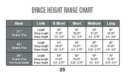

I find it interesting that people say that BH effects forgiveness.
yet here is Hoyts recomended BH.
So that follows that a 27" riser should have a 1/2" more BH.
It all gets mess for those that say a low BHs are less forgiving in my book. this post is here to challenge this coment.
So Short limbs are less forgiving?
and short risers.
So the fun starts when you think that when the limb has a small curve at brace height, the bow exhibits high vertical stability.
increase the BH too much and you get too much bend in the limb, and you get vertical movement of the NP.
too little bend in the limb, and you end up with a noodley bow. because the limbs start to bend the wrong way.
and the limb at brace height is regarded as the fadeout to the string contact area. (we call that part the mid limb)
after that you are into the recurve part of the limb.
Since all bows of the same model has the same recurve size, the difference between shorts and longs is the midlimb. so this means that its the length of the mid limb that dictates the BH.
other than that, Deflex in the riser also dictates BH.
The old addage that low brace heights being sensitive to shoot, could be based on the idea of reflexed or inline risers are sensitive to shoot, but also have low BHs.
So its a difficult idea to challenge without breaking out the different concepts. other than a blanket Low BHs = bad.
so if you have the right bend in the limb. (good vertical stability) and you have deflex in the bow riser, why else would a bow be difficult to shoot?
Seen in the Hoyt data above, you can have 7.5-9.5"
surely according to the low brace heights = bad crew. somethings amiss with 7.5,if 9.5" works...
yet you dont see 10" BHs.
#5 ·
here is some interest
http://www.dickwightman.com/howardhill/braceheight/braceheight.html
Bows and Brace Heights By Length:
Cheetah 69" Brace 6 1/2"
Redman 68" Brace 6 7/8"
Cheetah 66" Brace 6 1/2"
Wesley 66" Brace 6 3/8"
Halfbreed 66" Brace 5 1/2" *
Wesley 64" Brace 6 1/8"
Black Bear 64" Brace 6"
Wesley 60" Brace 6 1/4"
Tembo 60" Brace 5 3/4" *
Cheetah 60" Brace 6"
Bear Cub 56" Brace 6 7/8" **
Bear Cub 56" Brace 5 7/8"

#28 ·
Uukha runs a relatively high BH . . .
"Brace height:
We recommand to respect the value in a +-10mm range.
Lower the brace height if you focus on speed, increase it for stability and comfort.
Curve and Xcurve models are already very fast, moreover you will be able to use brace height in the bottom of the range to get even more speed.
Brace height 2015 range (and Vx1000 2014) previous generation
70" 225 mm 232 mm
68" 218 mm 225 mm
66" 211 mm 218 mm
60" 192 mm 199 mm
Tiller:
Tiller is the difference between the distance top limbs / string and the distance bottom limb string.
For Uukha limbs common settings between 0 and 6 mm are correct too. "

There is more to the hex and cv limbs than bh and speed. They introduced high TS and some commented that was unforgiving, yet now other limb companys are bragging about their increased TS. Are those same people avoiding new TS limbs by others, or eating crow? What happens if Hoyt introduces a new limb with 7" BH and you try it and wow, scores didn't go down. Do you avoid it with the old unforgiving argument or eat crow?
My scores suck compared to most, but I dont notice my hex6.5 being unforgiving. The arrow goes where its pointed, if it doesnt I screwed up. Whats the most forgiving limb, Ill go try to buy some points. :lol:
If you guys arent tuning using bh and just adjusting it by sound, how is that tuning for forgiveness? Why not set it at max manufactures bh for most forgiveness?
#49 ·
I have a <29" draw but shoot a 70" bow because it is more accurate and forgiving. I think that is likely due to the brace height and in fact I think the string angle is working against my face shape to some degree.
I've shot 66-70" bows with BH from 6.75-9.5", the low BH combo shot the worst consistently. Things start to get better past 8" and seem to peak at 9" but I'll merrily shoot a 9.5" BH for indoors.
Some bows are not forgiving and can make you question your abilities. No performance is free. It's when you ask for support from the manufacturer and get told that it's your abilities at fault and not a compromise in the design of the product that I have issues.

#52 ·
Sid,
Comparing a 70" Hill to a 70" Olympic bow doesn't mean much. They are too different. How does a simple 70 " one piece longbow have anything in common to a 70" Hex 7 limbed ILF rig, in complete target regalia, other than a similar brace and length?
Anyone can go on the general archery forums and read hours worth of threads regarding brace height and shoot ability. Compound forums have these arguments crop up weekly. There are the performance guys who argue short brace bows don't give up forgiveness and the accuracy guys who claim the opposite. Wanna cook your noodle? Read about the differences in parallel limb bows and upright limbed bows and how it dynamically effects brace during the shot.
As I've said, the newer tech is interesting and exciting to see. But, just because new materials enable new designs doesn't mean it overcomes the negatives those new geometries present. A large hook is like a large cam. Large cams spool in the string faster and technically support the string longer, too. But, the large cams also magnify the effects of torque. A compound has extremely stiff limbs, steel axles, and long risers. The torque a shooter imparts doesn't move those components much. But what happens if a person torques hard enough? It's either a derail or a way off center shot. Why? The torque has to go somewhere, it doesnt simply dissapper.If the limbs, cam, etc can't absorb it it goes one place, the string and arrow. Aggressive curves function similarily.
This is maybe why the new, big hooks are so polarizing. People have tried them, tried the recommended brace height, tried higher brace heights, and still found them wanting. That's their experience. As a manufacturer it would probably be better to accept that and thank them for trying your product rather than try to say they didn't tune them right or explain why they are wrong. That doesn't get people wanting to try out newer versions, which may be more forgiving, because people won't invest significant amounts of money in a company they feel downplays their opinions. That's the downside of a company spokesperson coming onto these forums. If you ask for opinions but generally just argue you run the risk of alienating people. Probably why you don't hear of Hoyt or Win Win or anyone else doing the same.
