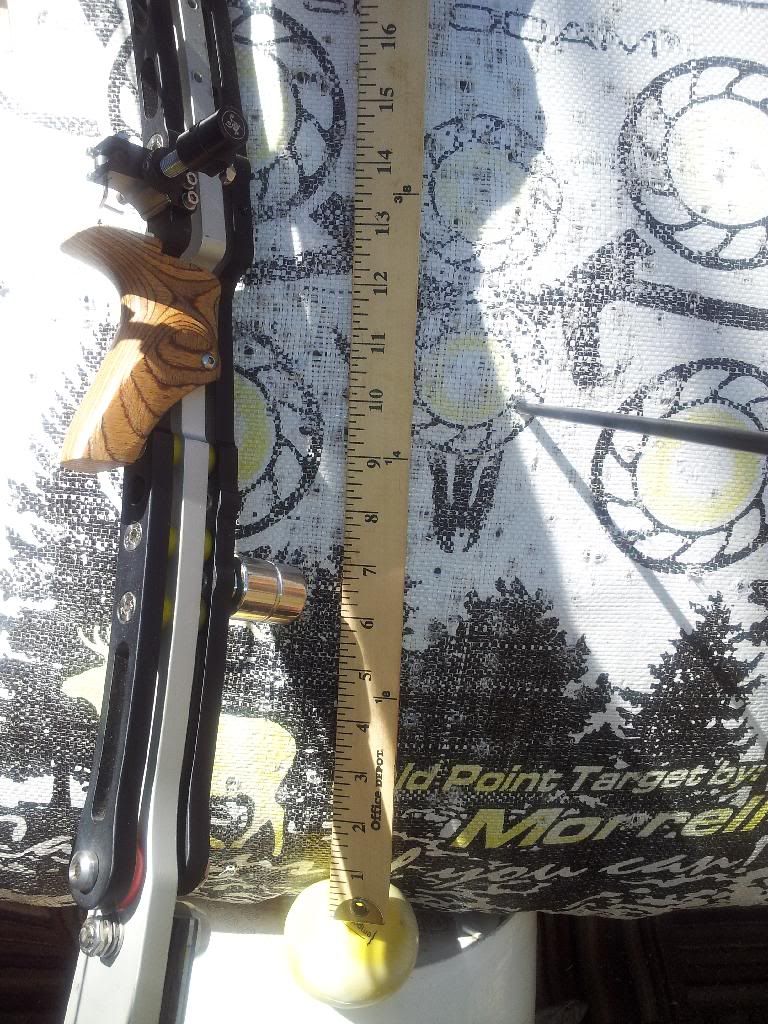

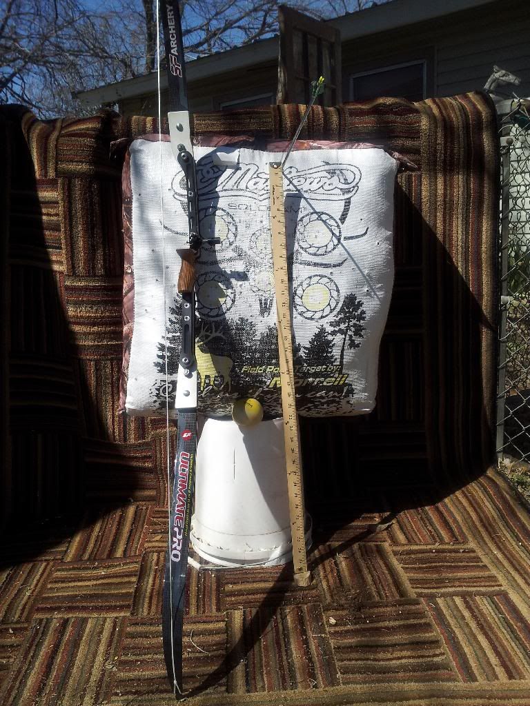

7 yards split finger index anchor. 1/2" arrow length hanging over back it full draw. I am direct aiming at the ball. The arrow hit 20.5" high. On the stacked dot field target it would be highly unlikely you would score well with a 20.5" gap

If you use a three under release with a middle finger anchor it cuts your gap in half

20.5" is ~50cm. Those targets are 20cm targets, I believe. So you need to aim 2 and a half targets below your target with point of aim. Can you cope with that? You might need to visualise a 'virtual' target sheet under the bottom of your sheet. That would give you a point to aim at.

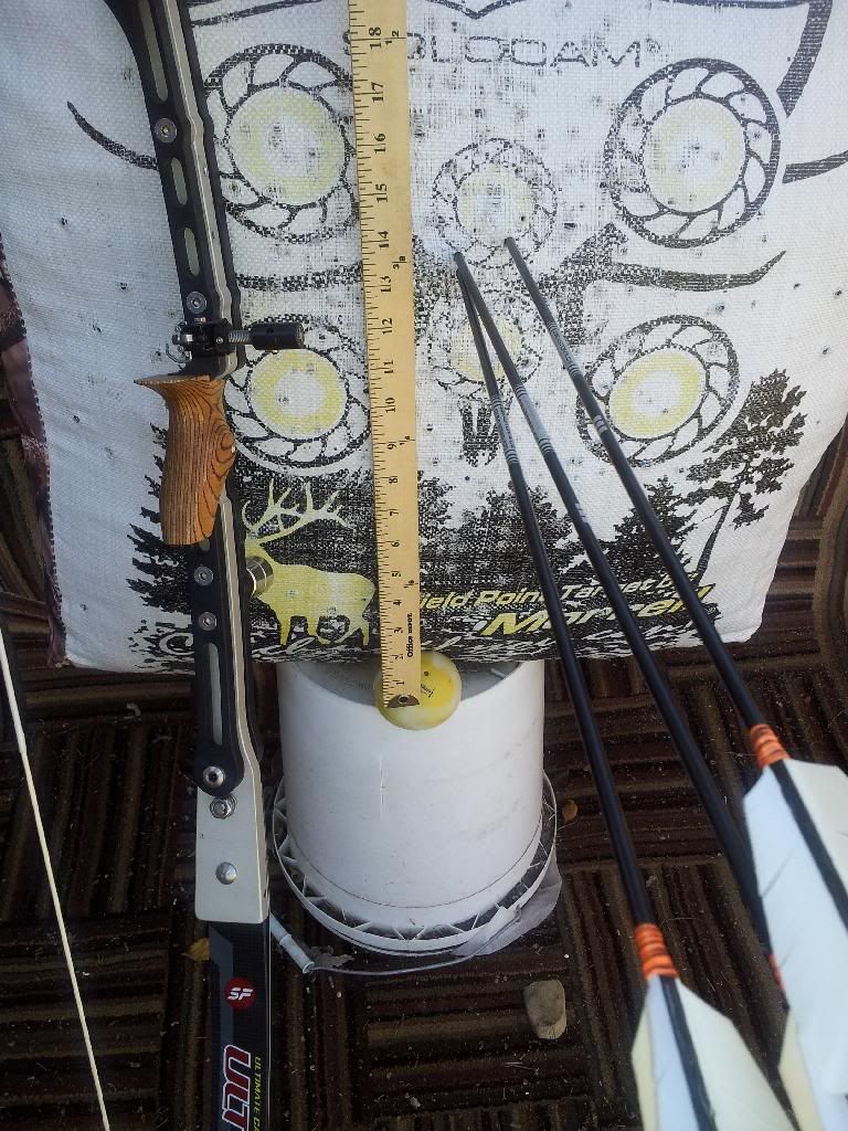

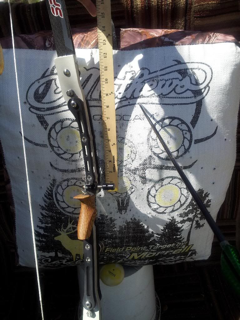

Tucking my draw up under my cheek bone bard I could only get a couple more inches. Just about an 8" gap with an arrow (little weak) 1/2" longer than my amo draw. now comes the fiddling. We can use a longer arrow. This would cut the gap at 7yds and increase the gap at 80 yards.
I was holding direct on bottom center dot. These are the arrows that were shooting weak yesterday.

Lets see what arrow length does at 7yards. Using three under release and a middle finger behind eye tooth. The 700 were 28.5" behind the point gave my a ten inch gap. These arrows are ACE 660 26&3/4" back of point. So this arrow is 1.75" shorter.
See less See more
So on the short distance end I lost three inches of gap with the 28.5" arrows. Now the question is how much did that 1.75" of arrow cost me in point on distance? this also begs the question how much point on distance did I give up from split finger with index finger release to three under middle finger release??
