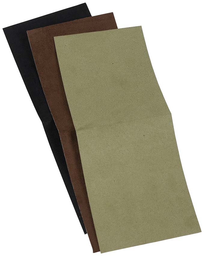

What kind of adhesive sheet did you use and where did you buy it? Thanks!
I was in a hardware store in Tokyo so not exactly easy to get! But this stuff from 3 rivers is similar... a little thinner (I have a pack, but haven't needed it yet):
Reactions: 1
